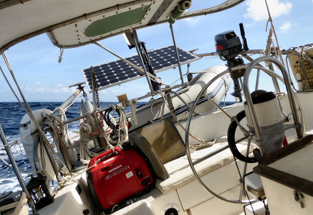

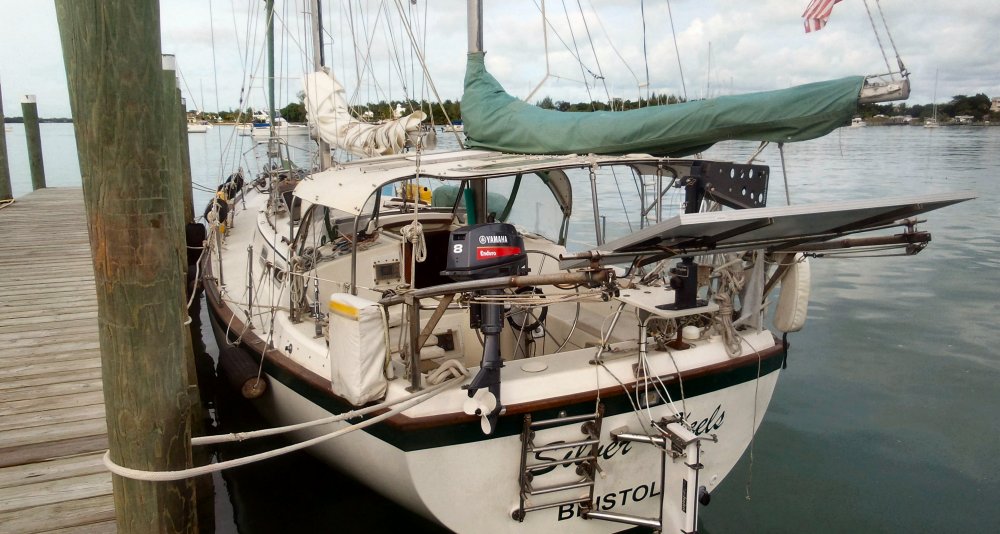

    Dennis,
    You’re right about Silverheels’ “almost there” davits. A tad higher is all they need now, plus more and stronger hoisting purchase to have the option of lifting the dinghy with its 8hp outboard on. I may leave those tweaks for the next owner, though.
    As you’ve indicated in your email below, the stern gear on a cruising boat is best approached as an integrated whole. IMHO, less is generally better, as I suggested in my little rant against jungle gyms earlier. Simple, strong, widely spaced davits are a real plus for cruising. I also wanted a windvane. That presented some conflicts, but I eventually worked them out. All windvanes except one (as far as I know) present an obstacle to carrying a dinghy in davits, requiring the davits’ arms to be disproportionately long so the hoisted dinghy can ride abaft the windvane. The one exception is the Auto-Helm windvane, made in America by Scanmar Marine, the same guys that make Monitor Windvanes. The Auto-Helm’s airvane connects to its trim tab by flexible cables instead of a rigid post like all other windvanes, so it’s easy to leave an open space for a hoisted dinghy to ride in between, snug against the vessel’s stern rail. Wide davit arms allow for a sizeable solar panel on a 1-plane pivoting mount, which is worth its weight in gold for the additional solar power output.
    Of course, a windvane requires offsetting the swim ladder, but Silverheels already had an offset boarding gate cut into her pushpit, so moving the ladder over was a no-brainer anyway. Admittedly, it’s a squeeze to use the swim ladder when the dinghy is hoisted in the davits, and with the mizzen sheet, a stern anchor, and other stuff “back there,” it’s kind of cluttered, but altogether the setup works. The one notable compromise I had to make is that I cannot tack the mizzen sail while the windvane’s airvane is upright because the boom won’t clear it. But dropping the airvane for the occasional tack offshore is not a big deal; only takes a few seconds.
    The attached photos may be more useful than my thousand words.
