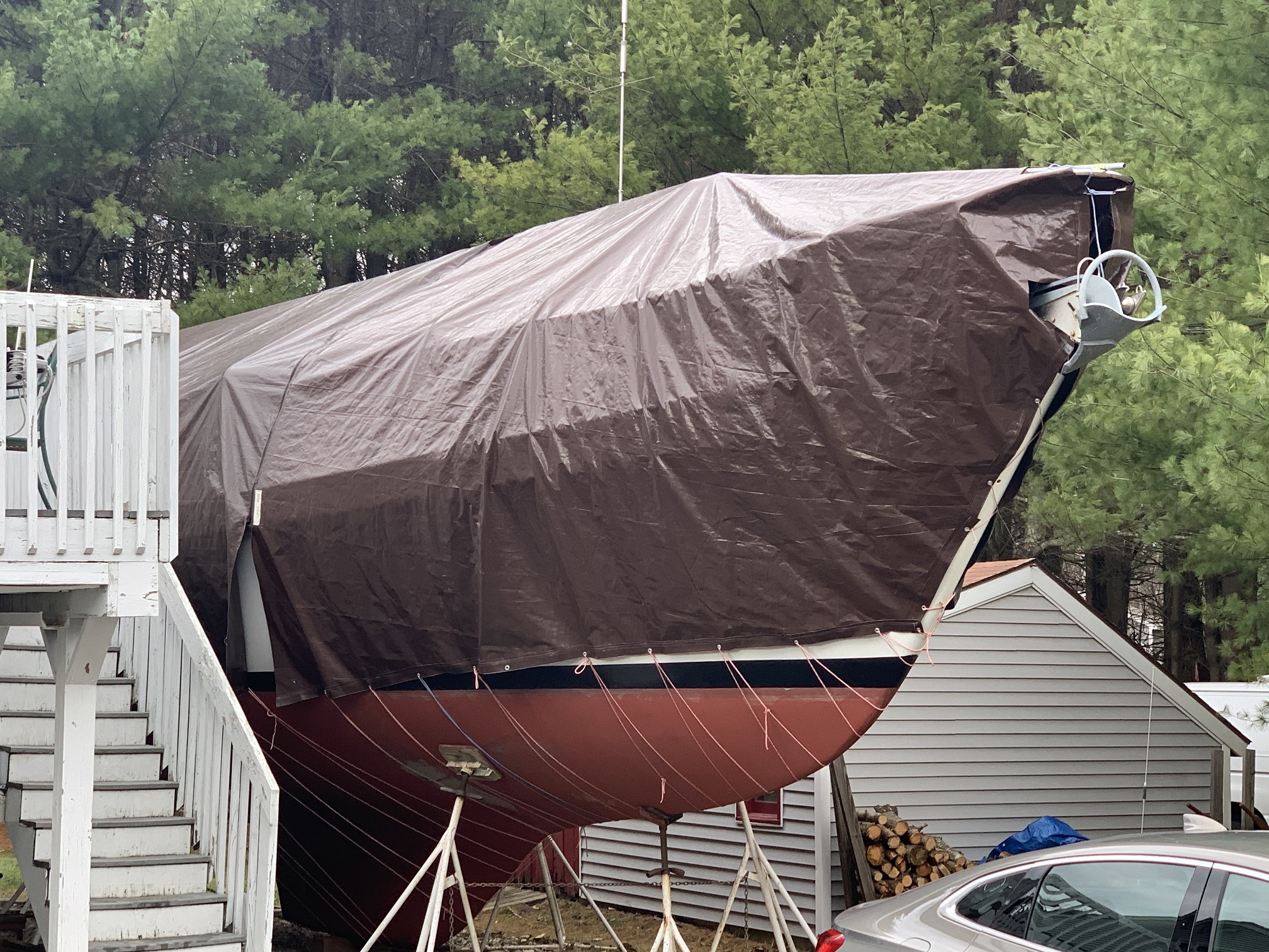

      I just finished making a new boat cover to replace my aging cover, photo attached. This is my third. It’s made from three 18×24′ tarps, each 16mil purchased from Amazon for about $100 ea. These tarps are heavier than what is normally available from big-box stores. I expect them to last 15 to 20 years. The center tarp is uncut. The bow and stern tarps are cut to fit the shape of the hull. The boarders of the two end tarps were cut off with their grommets and sewn back on these odd-shaped panels for tying down. The three sections zipper together with a pair of 8′ zippers. Sewing was done with a Sailrite machine. A home machine would not sew this fabric. The frame is made from conduit using frame brackets purchased from Defender. A 24′ 2×8 wood rib runs down the center supported by saw-horse brackets.
      The original cover had cut-outs for rigging and masts. I take the mast off for storage so there was no need to do those cut-outs. If anyone wants more info on how the frame was made and sewing hints let me know.
      Photo taken at my home where we store our boat. The stairs and deck make winter maintenance a lot easier than a boatyard.
