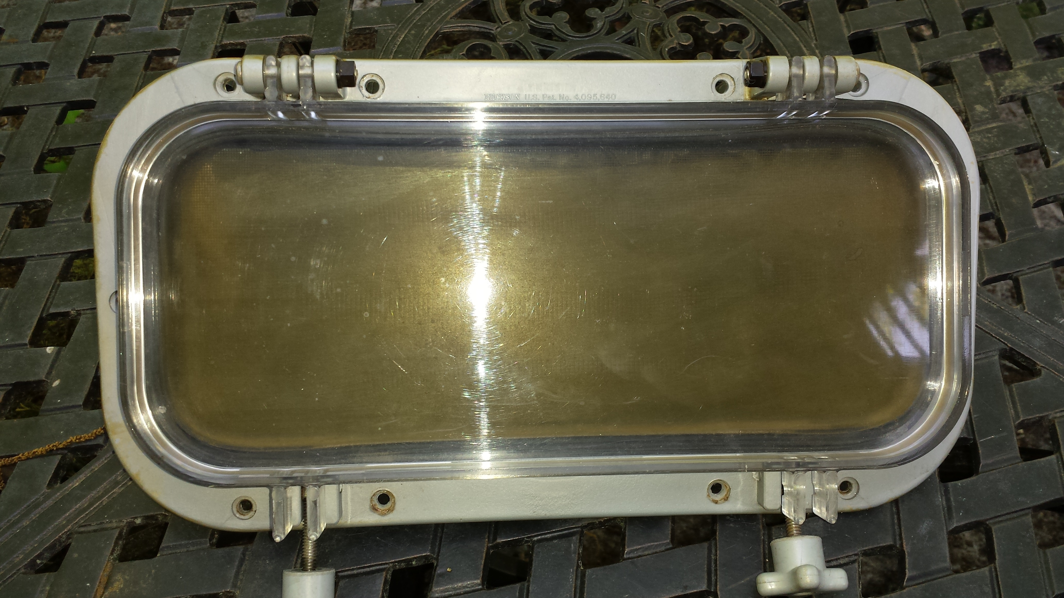

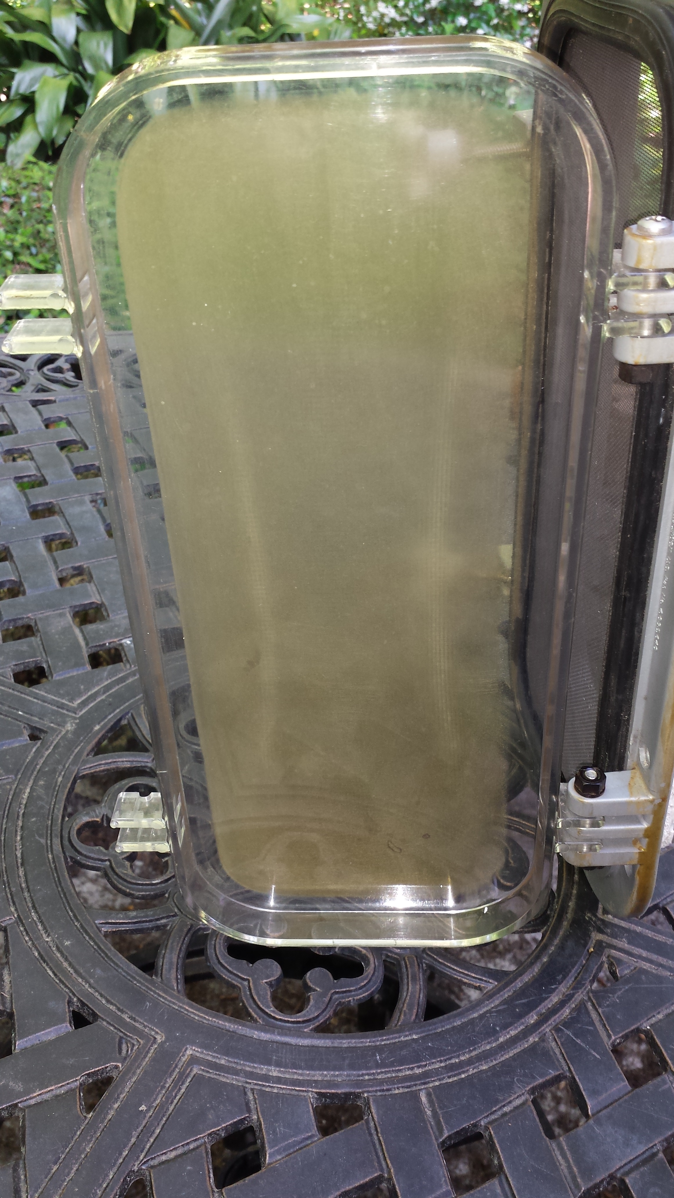

      OK. Have a photo of one of my Beckson ports. Let’s see if I can add the photos.
    • #220624
      skipmac
      I think I have added photos of one of the Beckson ports I’m removing. This one is pretty representative of them all. The lens is a bit yellowed from age and sun but clear with very little scratching.
      The hinges, tabs and latches are all good with no breaks or cracks.
      I have five removed so far with five more to go. Anyone interested I would like $40 each.
      Skip
