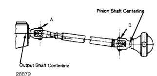

        Alignment is critical. The yokes of the u-joints must be parallel to run smooth. I’ve attached a drawing of a jeep alignment set up but U-joints are U-joins no matter where they are installed. Line “A” and “B” need to be parallel throughout their rotation or you will induce noise and rapid wear eventually letting the smoke out of the U-joints.
        The only way you can get away with misalignment is if you use a constant velocity (CV) joint which is what is used on front wheel drive cars. I would bet a paycheck that your noise is a result of misalignment since you mentioned you changed out the engine.

      Had never heard about the importance of the U joint axis’ being parallel. I guess in an automotive application that is engineered into the design.
