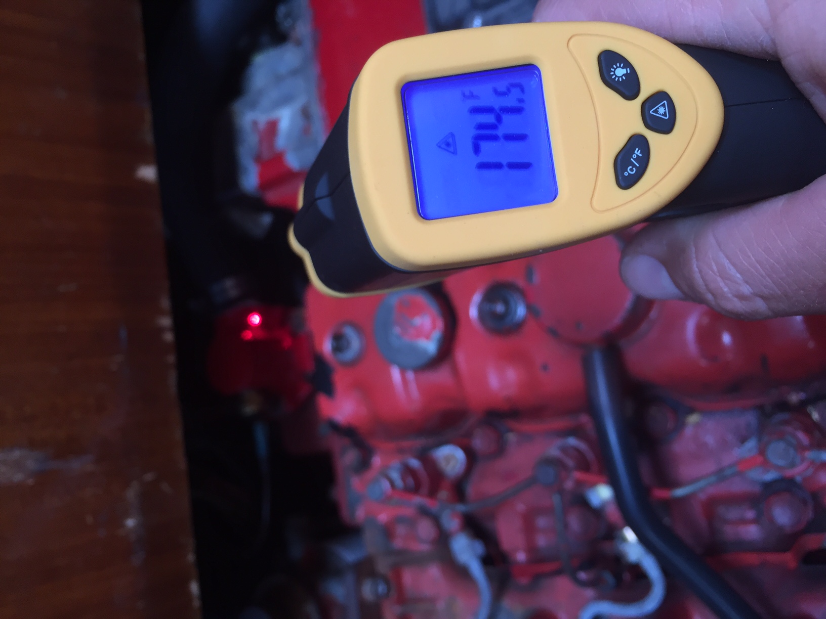

      Curious if anyone here has any insight to my issue. I have an original W58. Rebuilt about 3000 hours ago. Motor runs just fine. Plenty of power, no smoking, starts right up. No issues except this one:
      I have a high temp alarm on the engine that supposedly (a mechanic told me) is set to ring at 240F. It now rings without fail after almost exactly 40 minutes of running.
      However, my temperature gauge only reads about 179F and with my infrared thermometer the highest temperature I can read on the top of the engine is 175F. Of course, exhaust headers read hotter, but the thermostat housing and the block is all under 175. The engine doesn’t seem to actually be running hot.
      To make things even weirder, this is now the second high temp alarm this mechanic has installed (after we thought the first one was faulty because of the same seemingly premature ringing.)
      The one thing I’m wondering is if it’s actually a 200F alarm instead of a 240F and my mechanic is mistaken. It seems at least theoretically possible that while the outside of the sensor housing is only reading 175F that the inside could be 200F? Could I have another bad temp sensor? Or am I missing something?

      I think it unlikely that the engine is running at 200 degrees plus if you are measuring 180 at the thermostat housing with the infrared heat gun. I am assuming your overheat sensor is at the thermostat housing? You may want to read the thread ‘Hot W58’, which contains some data concerning engine temps that were recorded at the cockpit gauge and simultaneously with an infrared heat gun. Towards the bottom of the thread you can find actual recorded temps from Blue Moon and Discoverie.
      I suspect you may have another bad sensor or the installation location may not be optimal? Maybe need to go to a different brand OH detector? Or perhaps the electrical connections may not be correct?
