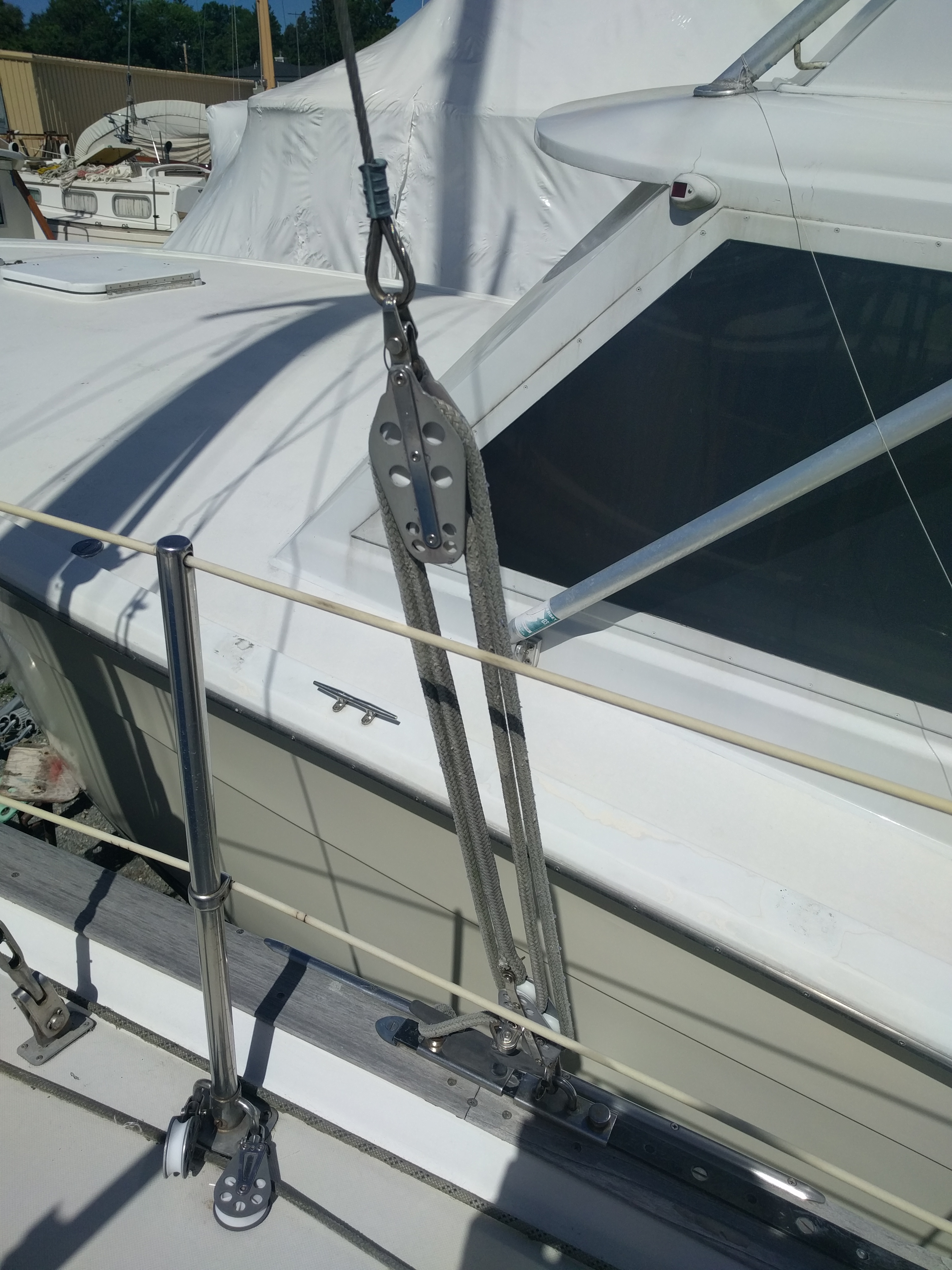

      I’ve got a cutter. I can send pictures of running backstays when I’m there Wednesday. Can’t go up the mast because she’s on the hard, but I can shoot the rest.

    • #221194
      robshookphoto
      Here are the pictures. Mast side isn’t pictured, but they run up to a point halfway between the spreaders and top of the mast. Let me know if you need more.
      Pearson 424 cutter - "Effie"

      The runners on my cutter are rigged the same way as Rob’s. From tangs on the mast between the spreaders and masthead to a tackle that attached to a ring slider on the genoa track on the toe rail.
