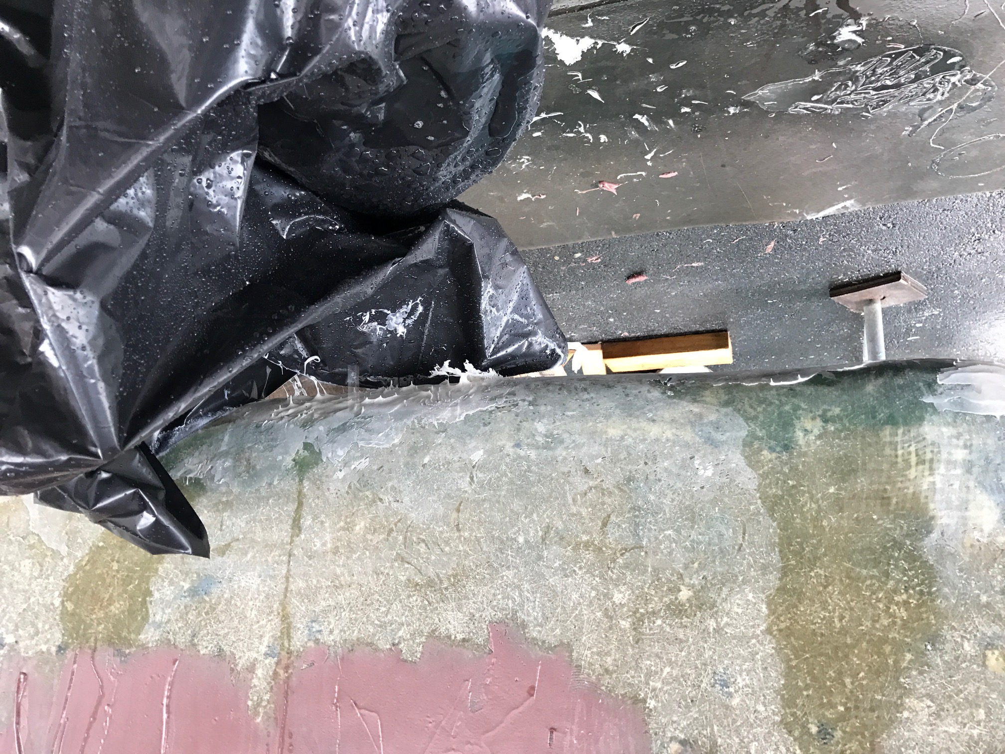

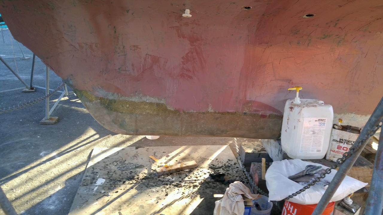

      All,
      I bought a marine shaver pro – forget the price, but it’s easy to find on Google, and a hepa vacuum. My boatwright used it and charged me about $1500 to strip the hull to bare laminate. We then let it sit for 6 months and only recently began to repair the laminate with sections of new biaxial and epoxy filler. Total bottom job isn’t cheap.
      With humility and gratitude.
